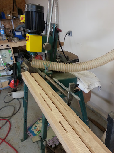

Les avancés du lit superposé...
j'ai fait toutes mes mortaises dans les montants
![Lit superposé pour noël -Z2TMoa2V8im_vpcf8ajDDP_n8hd0nHZald4M776MfYi_wrIuvPBY_KELDS1SX3P7wDvAbP_3kYaI6Oj6iK9TIQEo2-a92Colv8b0hI_UAcPv-BpbtOAF8ZRyJQSczpr_DWCYKyj8-RkBXjIxovl7NEyQEVNnua0kiNtZskzizGKc3xGYfH9U3FivKnyKPpW_JT0VKCb8C3lfMFkjQI1B5uRbGXxL7O0BihJhpIVS57e9CERtsxN1I0GvvZDw0Rea_KuSeLZbv-JXziWMtGL0T31abeis2lj4srKZUcG8axhGDVMpAKKMmlbDJX7qG5Eq5HIiNNRAE61AE_G9cAfDiFb6RuvUNkCGhelkGex29Thk1f4dH0JVa6YN0sKq6SfxhIPfXnMuO7ROno_CySTOsSUpeqHK1Av7aHEKmeah4gkeRzrMLPa_McM_Ri7gOn8Oej_hWwqaE4xhsxBIiuK7pRncFhTnIOILhSUJMAMaOaXV-7Uuu3U0x4zmsEupKFF1s9GAy3GvkV_TgDw6EkrtNXTBg2YtS_ESgwRDA8A_oJY=w389-h519-no](https://lh3.googleusercontent.com/-Z2TMoa2V8im_vpcf8ajDDP_n8hd0nHZald4M776MfYi_wrIuvPBY_KELDS1SX3P7wDvAbP_3kYaI6Oj6iK9TIQEo2-a92Colv8b0hI_UAcPv-BpbtOAF8ZRyJQSczpr_DWCYKyj8-RkBXjIxovl7NEyQEVNnua0kiNtZskzizGKc3xGYfH9U3FivKnyKPpW_JT0VKCb8C3lfMFkjQI1B5uRbGXxL7O0BihJhpIVS57e9CERtsxN1I0GvvZDw0Rea_KuSeLZbv-JXziWMtGL0T31abeis2lj4srKZUcG8axhGDVMpAKKMmlbDJX7qG5Eq5HIiNNRAE61AE_G9cAfDiFb6RuvUNkCGhelkGex29Thk1f4dH0JVa6YN0sKq6SfxhIPfXnMuO7ROno_CySTOsSUpeqHK1Av7aHEKmeah4gkeRzrMLPa_McM_Ri7gOn8Oej_hWwqaE4xhsxBIiuK7pRncFhTnIOILhSUJMAMaOaXV-7Uuu3U0x4zmsEupKFF1s9GAy3GvkV_TgDw6EkrtNXTBg2YtS_ESgwRDA8A_oJY=w389-h519-no)
puis après un montage à blanc
![Lit superposé pour noël B5p2Gqpe6FjeWil9rY17p4FiSO8eRzi3rZWa2ry4Cbor7VMfUTI-eGuJvO8uCBXGkIVwyVDN6mhaSIi6OPwMAW5-981ZI4fuTla5ndr5ZYRRxDpkf3aOTOr4ly7L-Xoi24PsvCAsFLvEfawLPPFEJM41pFDAjJmRnHfhQ3r5rMd79eSpT9Inz31ecwfgf4cfz5g5cm7FSZX7LE4TDMptGgnNi85TpzpMG1l3rQJ8fQZl2VbJBdwFlj2rZFB6iLx3g5_YpwLIpl5t0-RnX6Y_JugC8yL6xDzvC2ANV9trXI1i9pEs3eD7BpDbQVRCROK4PoH2TU7mJ8qpKd53SzdO7rT0YDMr9Et_dlL2bqdTUMza1y2x5tzP6RROU8yKM4cI3Y8L1ORaH6I-mjpT5zK4nPEOcO4pMrVWRJTxXVYqgEu6a-A4O0ctZGErQliFzZA3W5yrE_NQ7dkrqIp-kZXrn6cvPiaTfW5eg9mZ2VXtJ1x-OiQgXVbTmswILO-B59T0wPtQ7mt2wUCggRp9oh0InkkmqCWNQeWtygLohIq-J_Yk=w679-h905-no](https://lh3.googleusercontent.com/b5p2Gqpe6FjeWil9rY17p4FiSO8eRzi3rZWa2ry4Cbor7VMfUTI-eGuJvO8uCBXGkIVwyVDN6mhaSIi6OPwMAW5-981ZI4fuTla5ndr5ZYRRxDpkf3aOTOr4ly7L-Xoi24PsvCAsFLvEfawLPPFEJM41pFDAjJmRnHfhQ3r5rMd79eSpT9Inz31ecwfgf4cfz5g5cm7FSZX7LE4TDMptGgnNi85TpzpMG1l3rQJ8fQZl2VbJBdwFlj2rZFB6iLx3g5_YpwLIpl5t0-RnX6Y_JugC8yL6xDzvC2ANV9trXI1i9pEs3eD7BpDbQVRCROK4PoH2TU7mJ8qpKd53SzdO7rT0YDMr9Et_dlL2bqdTUMza1y2x5tzP6RROU8yKM4cI3Y8L1ORaH6I-mjpT5zK4nPEOcO4pMrVWRJTxXVYqgEu6a-A4O0ctZGErQliFzZA3W5yrE_NQ7dkrqIp-kZXrn6cvPiaTfW5eg9mZ2VXtJ1x-OiQgXVbTmswILO-B59T0wPtQ7mt2wUCggRp9oh0InkkmqCWNQeWtygLohIq-J_Yk=w679-h905-no)
j'ai poussé tous les quarts de ronds
![Lit superposé pour noël PNvaCT9_z6OOa2DJtboaHccHOSIjc8duQOb0f8TLiuNp3NUBpdbYdEK6kqZmUkvJt9hOTSugKTGfJAeBJoEuMl3gdoZsOjOClucZEHDU56oDgSgSmt6kX-kGNWvrAZYkOvPIinwSJ8raEZF0a2cG3nkprxq9gJZgyQMnNIr9dkLeQobW-t1e-ocezpUL0VXp58Pa0_jRRNWHWu85zCieOLi1cWx1blSKyEHKaQRnKXjDL0StEKVRqWa1sPhJI0kpw6u0dhhZ24KYG3KBQdPfb8e4C4Dum7KuBZcS4o_JpdvLNTEpJGH2GoMwQluQvfYTlnNn4HweFghSuAzMZttonT5XwxP5KFIgc2MrOI3HIsnLAp3N5kzx2t3g50keczf-2ZXeIIwXSFMtEtYV6pguCw7BmnM1eoEFarBieHOpcnECnTJaGFOu47vhuJZOqeZ7LVDq3_nLm5TWhGvSw_4wwFCPx2By3NxQW-p37VoPyp1anoPKKVmQG9Kb5Q2QDFRgw-8f53HovCHL5er2bBfvHdYNTpmgiKpOAurFHDq4Gqgw=w1207-h905-no](https://lh3.googleusercontent.com/PNvaCT9_z6OOa2DJtboaHccHOSIjc8duQOb0f8TLiuNp3NUBpdbYdEK6kqZmUkvJt9hOTSugKTGfJAeBJoEuMl3gdoZsOjOClucZEHDU56oDgSgSmt6kX-kGNWvrAZYkOvPIinwSJ8raEZF0a2cG3nkprxq9gJZgyQMnNIr9dkLeQobW-t1e-ocezpUL0VXp58Pa0_jRRNWHWu85zCieOLi1cWx1blSKyEHKaQRnKXjDL0StEKVRqWa1sPhJI0kpw6u0dhhZ24KYG3KBQdPfb8e4C4Dum7KuBZcS4o_JpdvLNTEpJGH2GoMwQluQvfYTlnNn4HweFghSuAzMZttonT5XwxP5KFIgc2MrOI3HIsnLAp3N5kzx2t3g50keczf-2ZXeIIwXSFMtEtYV6pguCw7BmnM1eoEFarBieHOpcnECnTJaGFOu47vhuJZOqeZ7LVDq3_nLm5TWhGvSw_4wwFCPx2By3NxQW-p37VoPyp1anoPKKVmQG9Kb5Q2QDFRgw-8f53HovCHL5er2bBfvHdYNTpmgiKpOAurFHDq4Gqgw=w1207-h905-no)
demain ponçage collage et assemblage
